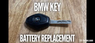

If you have the diamond shaped key and it’s not unlocking or locking the car you may need to replace the internal battery.
It normally charges as you drive the car but if the battery is worn out it won’t hold the charge as well.
Here is a video showing you how to complete.
https://youtu.be/FLluLorD3yo
Key battery replacement
