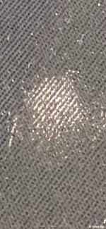

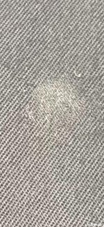

I'm looking for a product called "miracle clean"!, I have tried everything that has been mentioned in this topic so far apart from Surfex HD and I also tried white vinegar, before and after pics.

Could just be the photos, but those patches look worn/threadbare.

I spray strong, neat white vinegar and leave it to soak in overnight whenever mouldy patches appear.
Another spray the following day followed by a light wash with a soft wash mit. For any stubborn/deep patches you just need to let it soak a bit longer.
Pongs a bit but comes up like new every time. Been doing this over the last 6 years and it's a trick I garnered from my old man who's had ragtops his whole life.
You don't need an amoury of expensive cleaners and even light scrubbing is just going to help degrade the roof fabric over time. The white vinegar is as cheap as chips and 100% effective when used properly. The only drawback, as mentioned is that it can pong for a couple of days afterwards but it soon disappears, especially after the next wash.
Using a hardtop and/or covering the roof during the colder, wetter months also helps.

I'd give Chris_D's idea a go, and if that doesn't move it then it may be fabric density relatedAcestumacher wrote: ↑Wed Mar 29, 2023 5:50 pmI took a picture and zoomed in and then took a screen shot on my phone, must admit I am worried I have been scrubbing too hard.

When I saw this a week or two back it almost looked like white paint, though more likely to be pigeon crap. My lad lost a patch of paint off his Fiesta after he left pigeon s**t on his car too long. I think this could be a similar issue and the vinegar may be the next solution to try.inkey$ wrote: ↑Wed Mar 29, 2023 5:55 pmI'd give Chris_D's idea a go, and if that doesn't move it then it may be fabric density relatedAcestumacher wrote: ↑Wed Mar 29, 2023 5:50 pmI took a picture and zoomed in and then took a screen shot on my phone, must admit I am worried I have been scrubbing too hard.
